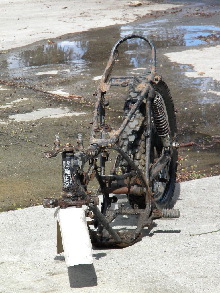

I have had a DT100C frame, swinger, rear wheel and triples...and one shocky for a few years.
Have had a few plans for it including bolting it on the outside wall with a bikes wanted sign or build some yard furniture inspired by this.
*But I have decided to get it together as a trailie again.....slowly.
Won't be anything like stock that's for sure as it will be made up of various Yammies from the 70's. Forks will govern the wheels I use, tank governs the seat, that sort of thing.
Here's what I'm starting with....
Seems the DT100C is as unique as the IT400C....not much at all in regards compatibility with other bikes....it will be a mission.
PS: As Leslie says....*because I can.
