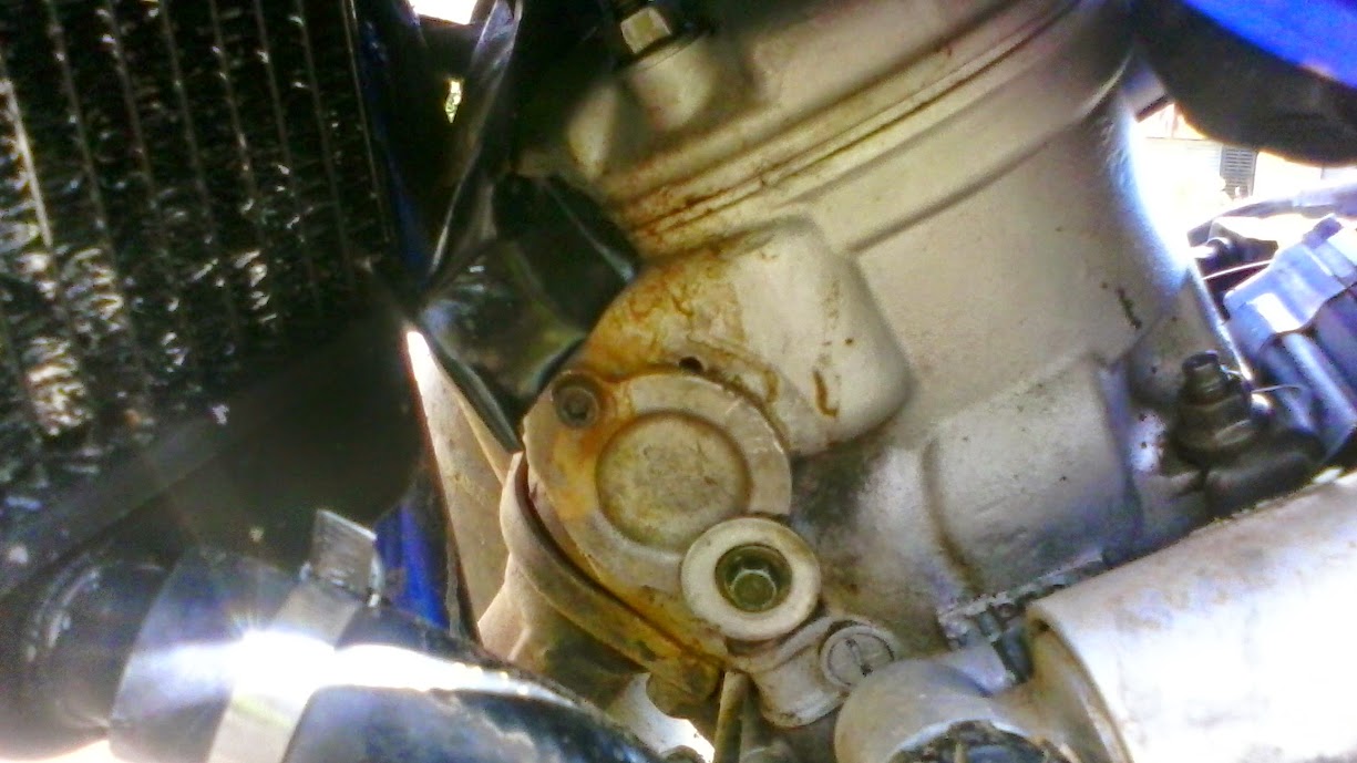

So now I've got proof, the jetting on the DT230 MUST be changed, the stock jetting will kill your DT230. Get the snorkel off, change the jetting and here's another tip...get rid of the power valve. I just unplugged the power valve motor and left it there, but pulled everything else out and put the same cap which goes on the right hand side into the left (I had a spare which I had previously broken trying to lever it out with a screw driver).
As I discovered the power valve is also a major constrictor which does not open as far as it should, which is to do with more emission crap. And yes I had the power valve cables adjusted correctly. Apparently fitting an older DT200R CDI will allow things to operate as intended. Performance difference without the power valve is astonishing, you would not know it's the same bike. The 4 stroke characteristics have of course gone, but with a little clutch abuse the DT230 will take off quicker than it has ever before. I already had the stock chamber on and thought I'd give the stock muffler a try as well. Couldn't believe it, the stock muffler gives the little ring dinger the perfect amount of back pressure to compensate for the removed power valve.

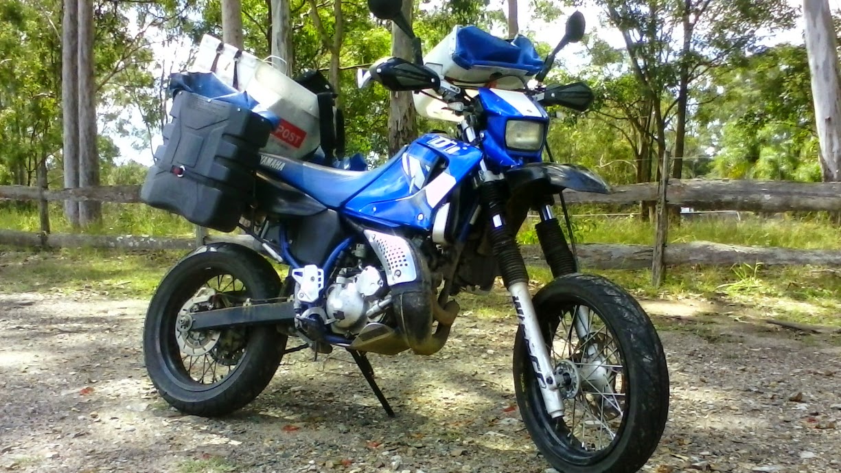

Here's mine now with close to 50,000 kms...DT230's rule.
