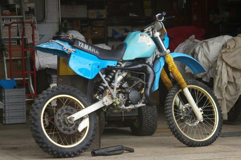

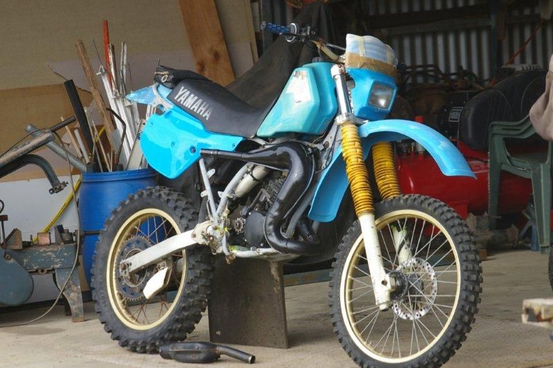

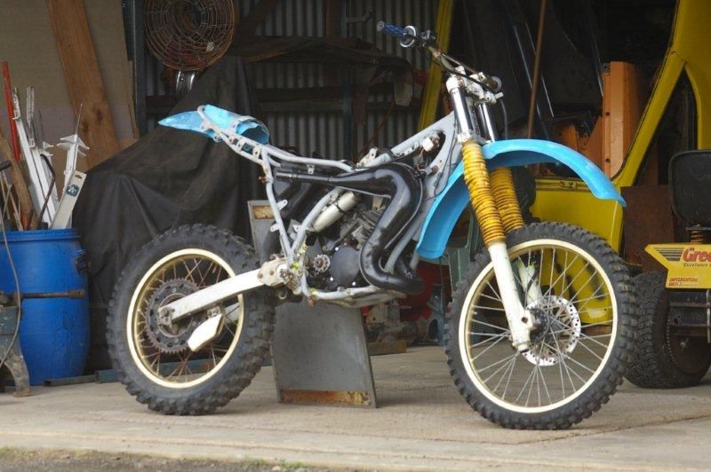

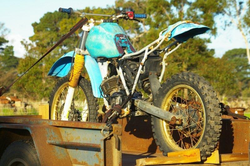

It200 S that got hit with an ugly stick somewhere along the way!!
Not complete ..so I need a parts bike to get this one back together  ;D
I have been gathering some bits already so tried them on for a look see....
Has the wrong shock so need a correct one
A speedo and bracket ..
New rear spokes ..wiring for the blinkers/voltage regulator horn etc.....
spare barrel,blinkers lots of screws and bolts..
Should be fun....

Crikey....really wish I could un-see that first pic!
The last few pics are rather appeasing though.... ;)

I love the height with that shock  ;D  It fits the front forks completely.  Should be just right for my height.  What shock is it?

I have no idea what the shock is ...

....the shock is seeing the first photo....  :o :o

That shock looks like YZ125 J or at least IT/YZ 81 or 82.

You have a nice project bike. And a Good one as well. :D The 200 is a great bike and you cant hardly kill that engine. I have had crank seals go out and the engine just keeps on running.
If your shock is to long it may cause some bad handling issues. A few guys have tried to put YZ shocks on with out much success. Get us a center to center distance of the shock bolts and we can compare it to the correct shock. The only YZ shock I am aware of that is even close to use on the IT200 is the 84 YZ125 and it had both compression and rebound clickers.
Is that a new side panel or did you clean it up?? If you cleaned it up what method did you use?? AL

i just bought a 84 yz125 shock, waiting for it to show up.  will let you know the results.  the yz250 shocks will not fit.
The 84 YZ125 shock is just a few mm's longer than the IT200 shock. In your case it might help a lot being you race the bike. I will see if I can find my shock lenght chart. Check the link below. It shows, Make, Model, Year, lenght & etc. Al

the reason i'm going to try the yz shock is to get a little height, and racetech lists a bigger range of springs available for it...
