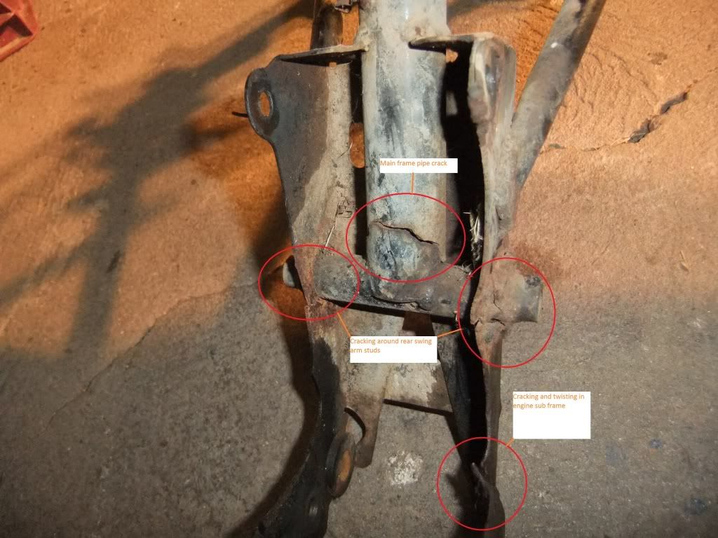

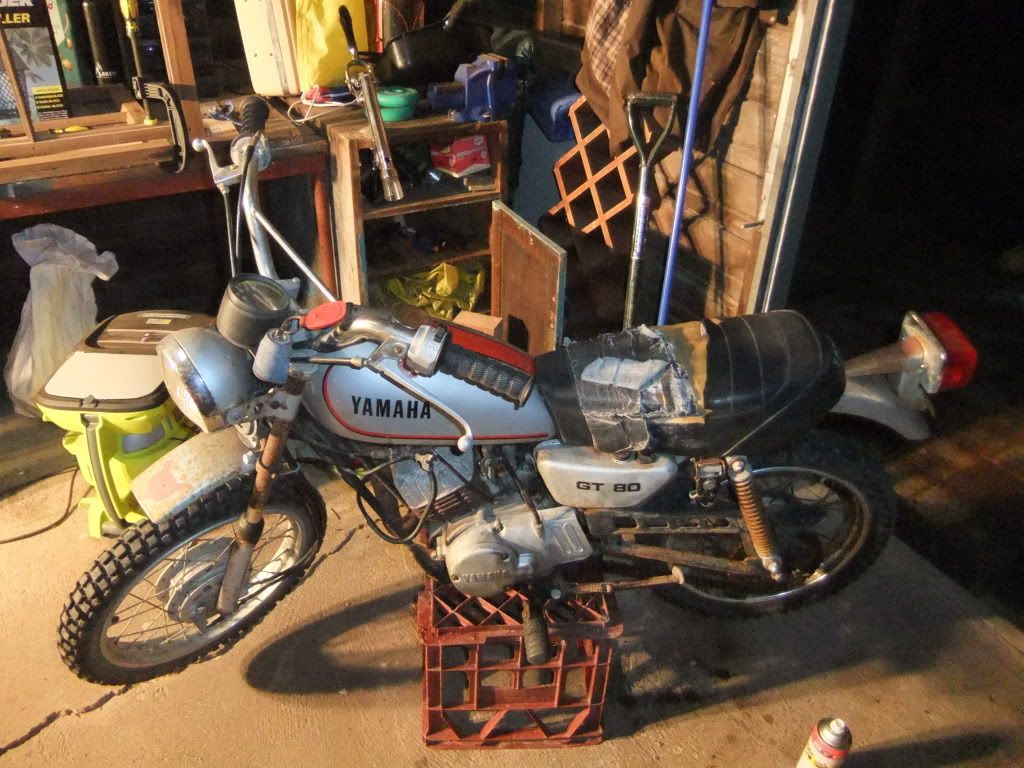

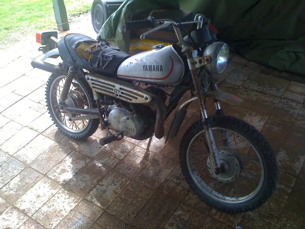

Here are some photos of the GT...
A couple of pics taken before the strip
Damage to frame..... I hope whoever welded this is not a boiler maker by trade.

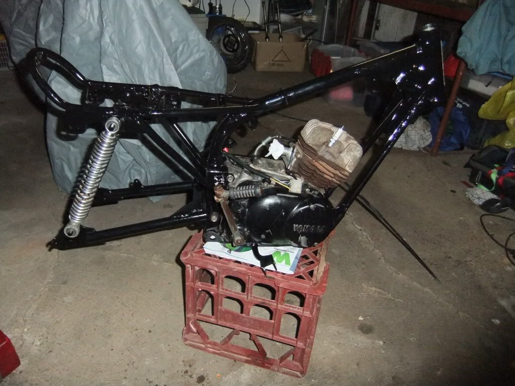

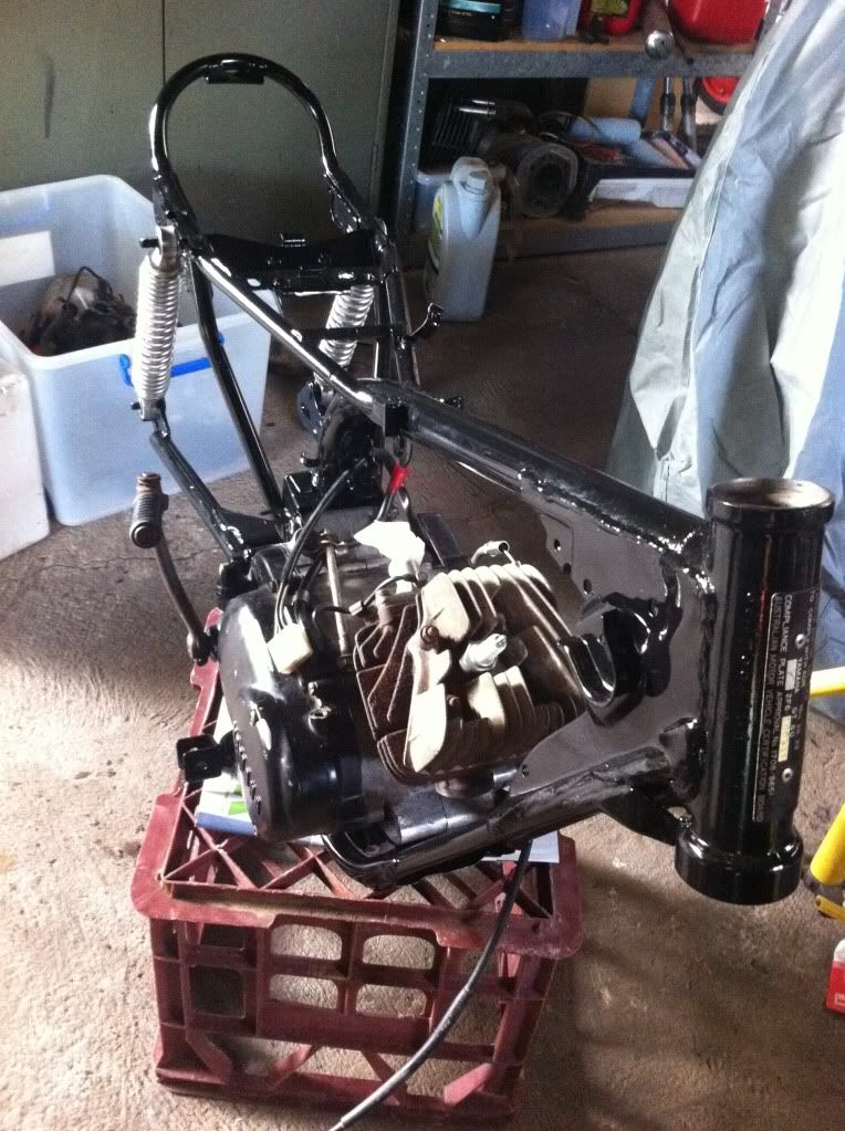

Build so far..
I am painting all of the guards, tank and parts using rattle cans. Have read some good articles and watch some vids on how to do this correctly, so i thought i would give it a shot and save some money.
The hardest part so far has been waiting for right weather, to much bl__dy rain  >:(
The undercoats have come out well. Will try and get some pics up of these later.

looking nice and tidy!! rattle cans are good.. I've done frames with them in the past, good stuff!!
that's pretty rough!! I doubt the numpty who welded that would be a tradie... that frame actually might be salvageable, cut in the right place (on the welds on the engine cradle and just above that engine plate) the frame could be cut and shut with another frame keeping the number from that frame and replacing the damage with the other frames parts, any welding place would be able to do it cleanly and that would solve your matching numbers problem.. you wouldn't even notice it.  ;)
