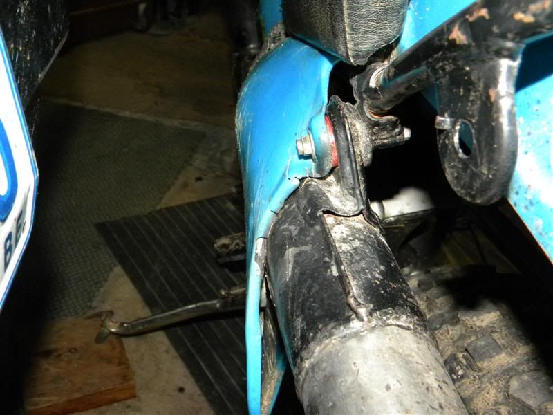

I need some kind and trustworthy member to lend me a suitable LEFT HAND SIDECOVER.
I will need it for two weeks.
Preferably an eastern Melbourne member, so I can pick up and return part.
Once I have molds made for the sidecovers, they will be available for members for cost of materials and postage. Say about 40 a side or 60 for both.....
They will be grey in colour until I can achieve an exact colour code to match.
I will be using my split right sidecover to mold from.

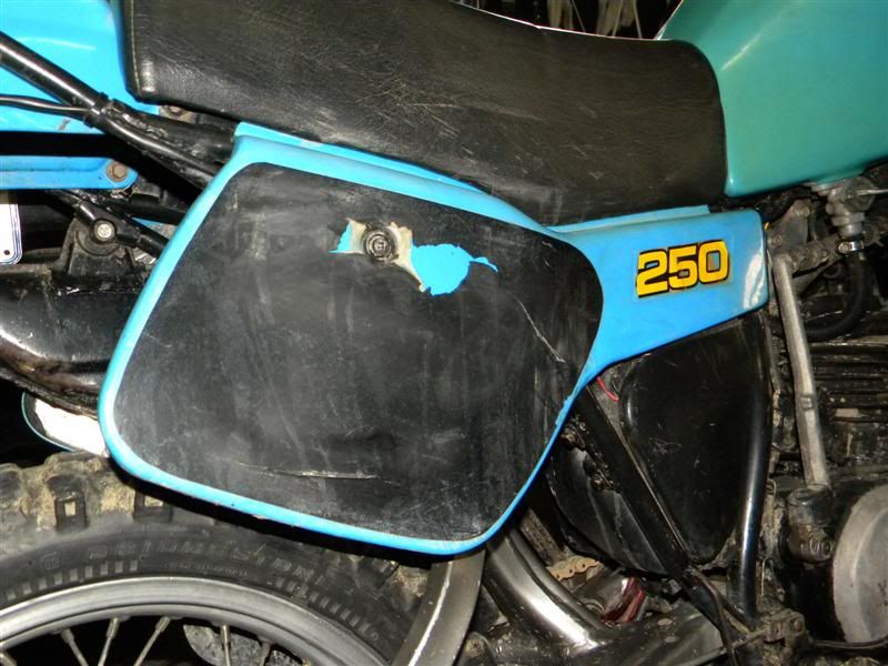

There are some points of note:

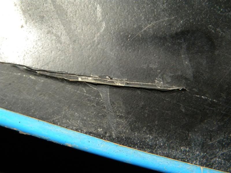

My right sidecover is okay to make a mold from even though it has a split. This split can be closed and the corresponding mark taken out of the mold prior to production.
My stickers must be REMOVED. They do not sit flat. They maybe damaged during molding process.
My alien face sidecover is obviously not good to replicate.....
Cracked edges or badly distorted cracks are not good.
Heat has distorted this plastic beyond practicable use, however, scratches are okay. These will result in a raised line in the mold that can be blocked down prior to production.

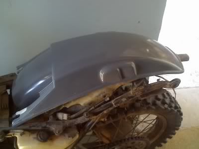

This a recent guard made to suit 1976-79, DT250 and DT400, (maybe others too) and is indicative of the end result. They weigh about the same as plastic but are NOT AS FLEXIBLE. Easy drilled, sands easy and will accept many paint types.
I will be making molds from my own front/rear guards and headlight over the winter months.

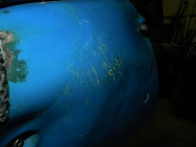

I have a question or three however ???
I have not seen a good-decent-new sidecover for myself. Only photos.......
Is there a fine line inscribed for where the yellow/black number patch goes?
Is this mark or "print-through" line from the flange on the rear, evident on new covers?
Is there a dip, or shallow recess anything like what is evident in the following 2 pics?
Hoping somebody with a brand new one could pop out the shed and take a look, there is plenty of grouse shiney bikes out there everywhere....I know, I like looking at the pretty pictures.  ;D ;D

On NOS ones the yellow is actually paint. The only depression is where the 250/465 decal sits.
Any marks or lines on your's is most likely from a knife when cutting a vinyl replacement decal for the yellow. It is flat from new.

Thanks fellas, I think that decal line on mine is actaully a fine line of glue from the decal that was on there for a couple of decades. A brisk rub with my thumb made the line black and 10mm wide!! Those depressions from the mud shield affixed to the back can be erased on the mold, but if it is on there from new...I ain't changin' it. I know all the tanks have a seam line running down the side that is more or less pronounced on different bikes. Some look like a split and others with only a slightly shiner line.
